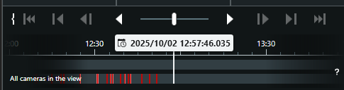

When I switch from Live to Playback, I want the time to be at a specific point.

Yes, so currently I successfully open the OpenFloatingWindow. However, when I switch to playback, I would like it to start at the triggered time instead of the current time. Is this possible? Currently, the playback begins at the current time when I switch.
You may want to send a message of type SmartClient.PlaybackCommand with Command set to PlaybackData.Goto and with destination being the FQID of the Playback Controller of the floating window. You can get that by calling ClientControl.Instance.GetPlaybackController with the WindowInformation of the floating window.
