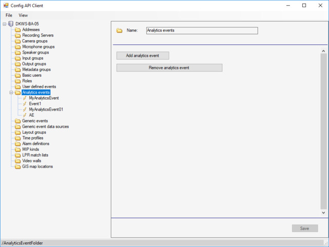

You can create an analytics event using the Configuration API, which later can be triggered by various methods.
Try to explore the Config API Client sample.
Or try this using the strongly typed classes..
using VideoOS.Platform.ConfigurationItems;
private void CreateAnalyticsEvent(string name)
      ManagementServer ms = new ManagementServer(EnvironmentManager.Instance.MasterSite.ServerId);
      ms.AnalyticsEventFolder.AddAnalyticsEvent(name);
