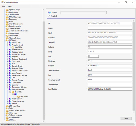

You can do this using the Configuration API.
See this screen captures I made by using the Config API Client sample:
Thanks Bo,
So if I understand correctly, the sdk must be installed on the same machine where the managment server is running to see these additional features “MIP kinds”. Right?
The Config API Client sample is an application. This application can run in any Windows PC. A MIP SDK based applications do not need the MIP SDK installed in order to run, but a MIP SDK based application is depending on dlls from the MIP SDK Bin folder.
Recommended read - https://doc.developer.milestonesys.com/html/index.html?base=reference/architecture/net_library_initialization.html&tree=tree_2.html
Please also note that you do not need to run the sample in the Management Server, it will work as long as it can connect to the Management Server, it will work same way as the Smart Client in this regard.
