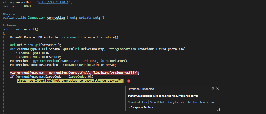

where did you get the connection, help me do that, thank you very much
Do you have an example to connect? I consult with
Can the above example retrieve records in .net 7 from XProtect smart Client 2023 R3 and save them to minIO?
For establishing a connection you can do the same as in LiveSample:
https://github.com/milestonesys/mipsdkmobile-samples-dotnet/tree/main/.NET%20Framework/LiveSample
Mobile SDK is built as a .NET Standard project. You should be able to use it from any .NET version.

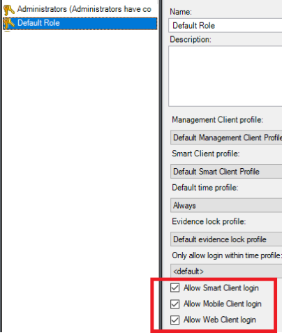

Thanks, Can I log in with my XProtect Smart Client 2023 R3 account to get records using Mobile.SDK?
please, help me! Thanks
It depends. You user should have Web/Mobile access to use the Mobile SDK.
Users are managed in XProtect Management client:
Please create another forum thread if you have more questions.
