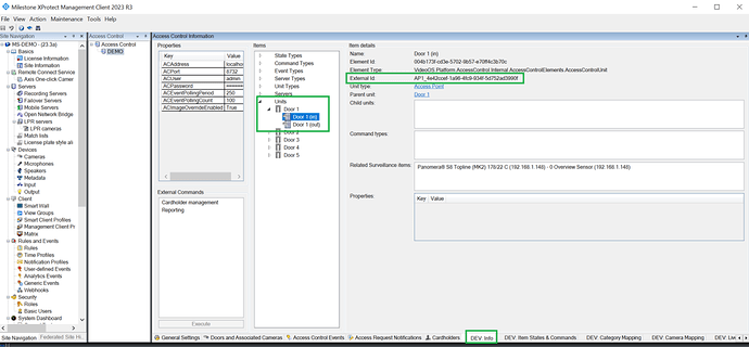

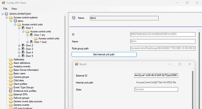

There is in the Configuration API (and REST API) a way to get the Milestone path (Get internal unit path) if you have the External ID.
There is no functionality for going the other way.
