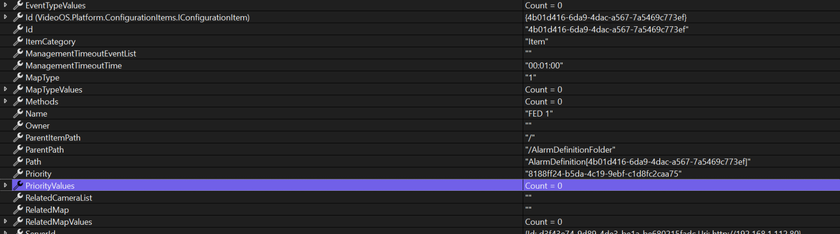

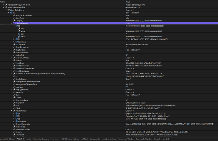

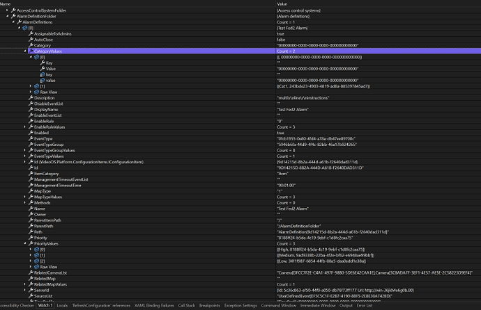

OK thanks, do you have any idea why the alarm definitions on one server provide the priorityValues, but on another identical similar server (2023R3 with hotfixes) the PriorityValues are empty?
For example, I am connecting the SDK to FED1 (top of the federation) and the priorities are empty, but when I check the alarm definitions in FED2 (federated to FED1), the priorities AND categories are available, even thought there is no selected Category for the Alarm Definition:

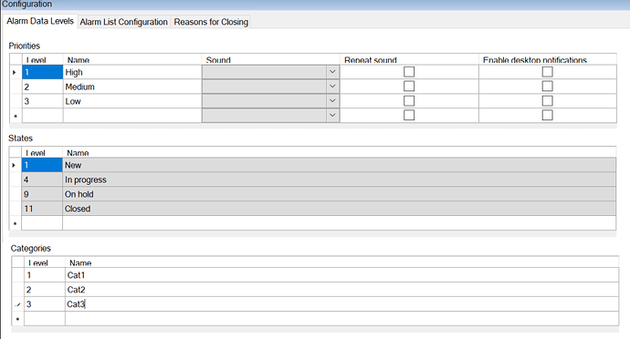

Per default there are no alarm categories, please double check if you have defined alarm categories. You will have to use thee Management Client to check this.
Yes that is what confused me.
I have indeed added custom categories to both servers.
