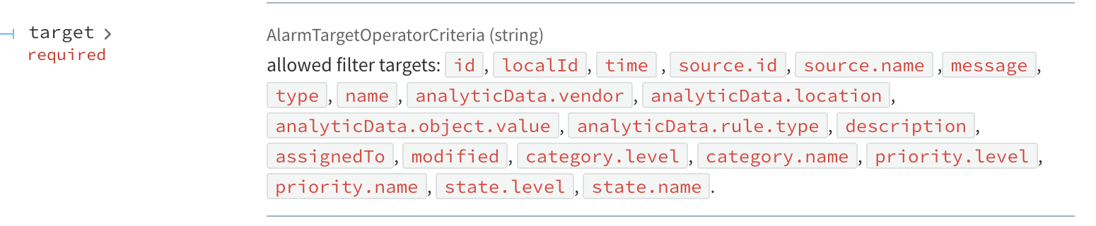

Refer to the below API.
Here in the allowed target for filterBy, there is no field named lastUpdatedTime.
I figured it out, but I must admit I needed help from Milestone Development.
The target ‘modified’ will filter on lastUpdatedTime!
Changing your example, this works:
{ “operator”: “gt”, “target”: “modified”, “value”: “2026-01-05T07:00:00.000Z” }
