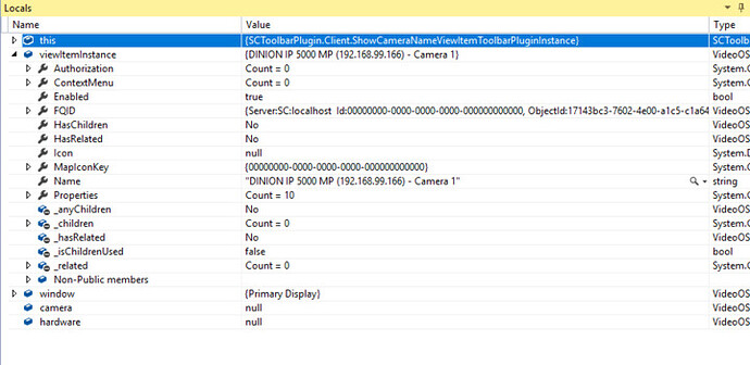

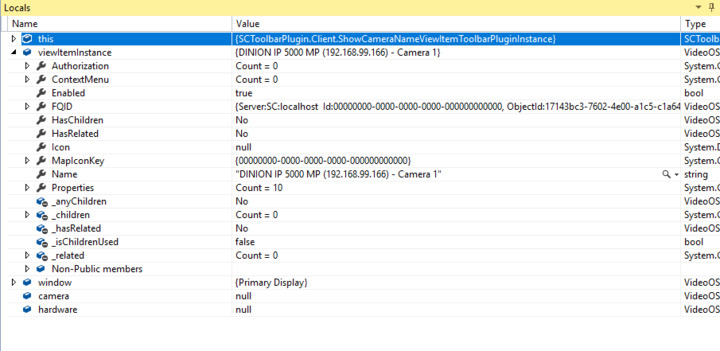

You will have to use the FQID of the camera, not the FQID of the View Instance.
the viewItemInstance isn’t a camera? See the image of the image of the Locals when I hit that line.
No it is not, in this case it is confusing that the ViewItemInstance inherits the name of the camera.
