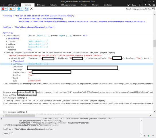

How to format playbackGoTo to start video at a specific time please?

Generally speaking it should work in this way.
Please bear in mind that Playback Controller has a timeout if no any video steams are attached to it.
It shares the same value with video channel timeout, which by default is 30 seconds.
So it could turn out that controller is timed out and closed by the server during debugging.
This timeout could be increased from the Mobile Management Plugin (in the Management client):
I’ve spend some time in order to prepare working sample for multi-camera playback.
You can find it attached.
You can copy it to “Samples” folder.
Again after loading the sample, click on at least 1 camera in first 30 seconds in order to not timeout the controller.
