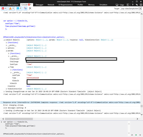

var option = { VideoId:Id,
seekType:“Time”,
Time:playbackTimestamp.getTime()};
XPMobileSDK.playbackGoTo(VideoConnection=videoController,option);

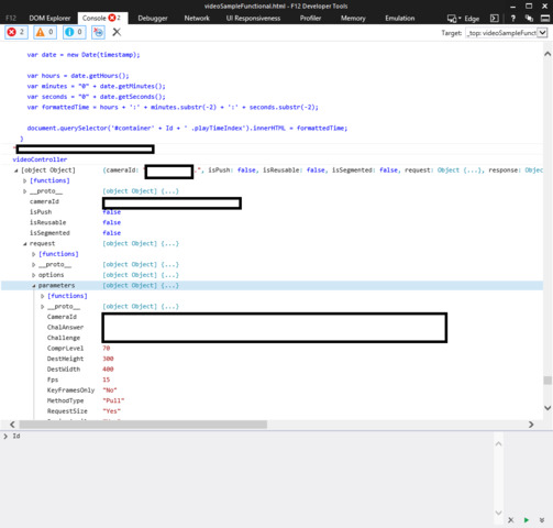

Upon updating from console, functions update ok without error and parameters appear defined ok, however no update in video feed.
I see that updateTime() updates the time in the div for the cam, however not the video. Interested in learning the format of the solution to play forward from playbackGoTo() please.

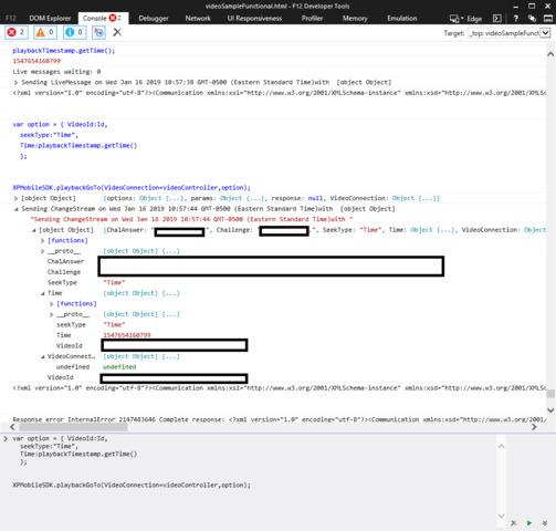

Results in videoConnectionObserver not defined
Playbackgoto command change stream specifics in console indicate that ‘videoConnection’ is not defined.
Status of VideoController object assigned to videoConnection appears ok.
Also there are instances of error code 2147483646, which from what i read from the forum is undefined or unknown.
Looking for direction on what to check next please.
videoConnectionObserver is undefined2
Internet describes .getTime() converts to the correct time milliseconds from unix epoch format. Units defined in time in third screen shot.

Prior the attachment, I was simply loading all the functions in camera into console after session was loading and experimenting from console.
The attached .js appears to update a div to the specified. Which is progress. Not able to verify what time is active, per the absence of a controller however. Still in progress.

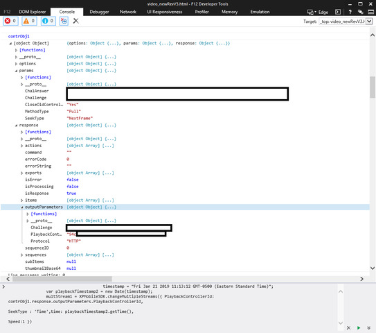

Regarding ConnectionRequest, found solution through createPlaybackControllerCallback without the parenthesis and input, createPlaybackControllerCallback(connectionRequest).
Also, learned that connectionResponse.parameters.PlaybackControllerId ran without error vs connectionResponse.outputParameters.PlaybackControllerId.

Next, aiming to move what was learned about moving time into requestStream, into the requestStream that is in createPlaybackControllerCallback and go from there.
Will there be a new controller format on the div when the createControllerPlayback controller runs ok please?
At the moment, interested to learn how to apply the new PlaybackControllerId to update the time.

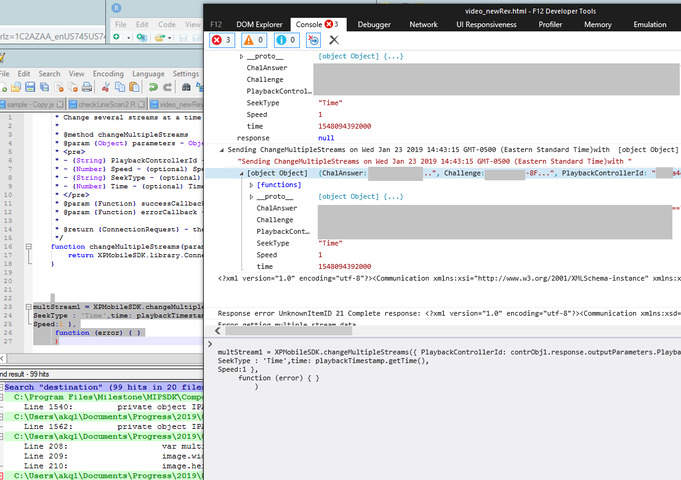

Update, resolving error unknownItemID21 in referencing PlaybackControllerId in changeMultipleStreams,
multStream1 = XPMobileSDK.changeMultipleStreams({ PlaybackControllerId: contrObj1.response.outputParameters.PlaybackControllerId,
SeekType : ‘Time’,time: playbackTimestamp.getTime(),
Speed:1 },
function (error) { }
Error getting multiple stream data
Thomas
posted a file.
where contrObj1 = XPMobileSDK.createPlaybackController({ SeekType : ‘Time’,time: playbackTimestamp.getTime() },

Notes after some more troubleshooting:
The following is placed just prior the first match of document.getElementById(‘container’ in the function Camera(event).
timestamp = “Fri Jan 21 2019 13:13:12 GMT-0500 (Eastern Standard Time)”;
var playbackTimestamp = new Date(timestamp);

contrObj1 = XPMobileSDK.createPlaybackController({ SeekType : ‘NextFrame’ },
//function (error) { }
console.log(contrObj1 );
with the following commented out:
SeekType : ‘Time’,time: playbackTimestamp2.getTime(),Speed:1 })
Attached images are the result of running the above changeMultipleStreams in console.
Is there a solution regarding referencing changeMultipleStreams with PlaybackController id to update video to time please?
