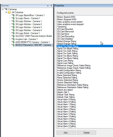

For example I have a Bosch Camera with a lot of events added (and all enabled), see image, but I’m not getting any of those events back as a result of the call above. Am I missing something?

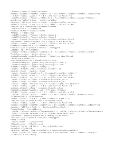

See also attached list of all events returned as a result of the call (GetAllStatusEventMessages.txt).

I have found a test camera. I do see a lot of the events. It might be a coincidence you are on “Signal Too Bright Rising” but I used that one for my investigation and I found it with a slightly changed name: “6-18-3-Signal Too Bright-0”.
Is this what you are looking for?

I had another look and it seems most are probably in there as you say but with a slightly different name (I was expecting the names to match up exactly so didn’t notice that). But will go through the list again and see if I can try to map them up.
