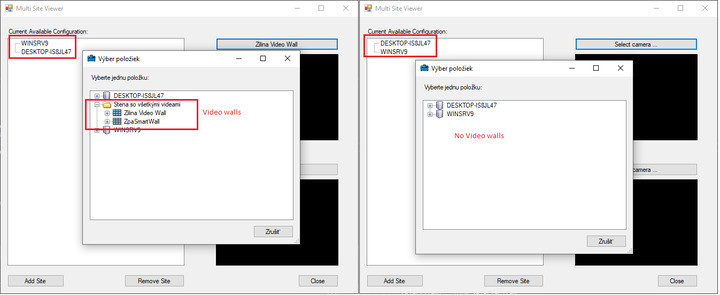

I can reproduce it also in your Multi Site Viewer example (I changed filter in select camera button from Cameras to VideoWalls):
It seems it gets video walls only from server in Configuration.Instance.ServerFQID.ServerId and it ignores other connected servers.
It works fine for Cameras: Configuration.Instance.GetItemsByKind(Kind.Camera). I always get all cameras from both servers.
