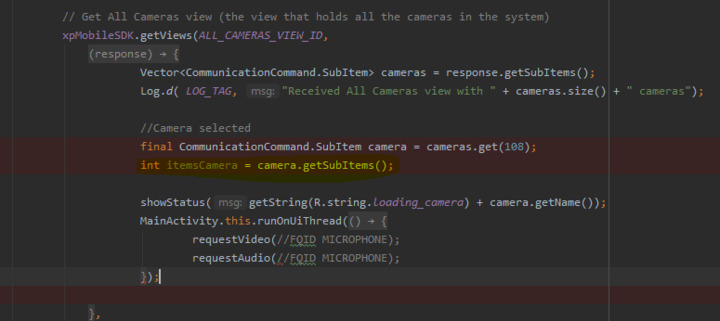

I’m using MIP SDK Mobile for Android with example “LiveVideoSample”.
This is my code where I use the getViews method to get all the cameras, but when selecting one in particular I would like to get FQID from the microphone and I don’t know the code for this.
The camera.getSubItems () method returns an integer in response.
Thanks for the help,
Dario

GetSubitems will just return the number of subitems; to get the actual items you can make another call to GetViews using the camera Id:
if( camera.getSubItems() > 0 ) {
    xpMobileSDK.getViews(camera.getId(), new SuccessCallback() {
        @Override
        public void onSuccess(CommunicationCommand resp) {
            Log.d("getViews", "Received subitems of " + camera.getId());
            Vector<CommunicationCommand.SubItem> subitems = resp.getSubItems();
    }, new ErrorCallback() {
        @Override
        public void onErrorOccurred(CommunicationCommand cmd) {
Of course, this is not very efficient as it makes a network call - but it’ll do the job
Another apporach would be to get the list of all cameras and views, using xpMobileSDK.getAllViewsAndCameras(…) and parse the result recursively, which is more efficient but requires more work.

Hi Plamen,
Thanks for the help, it worked perfectly,
Dario
