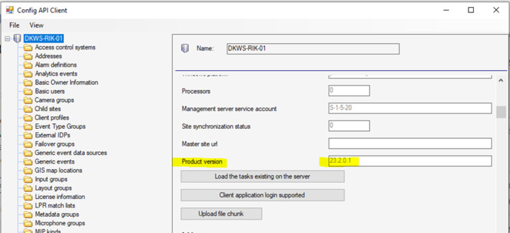

I also need Milestone Version installed ? How to get it
You will get product version when you run the sample – select the top and there is Product version.
It is by design that you only get the code name (like XPIM) on the licenses.
