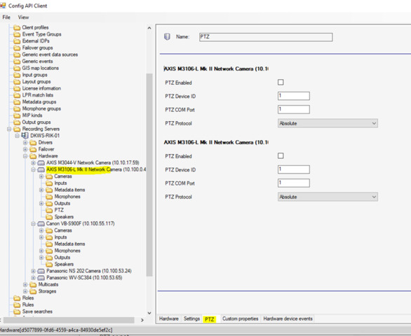

1, Please explore ConfigAPI Client sample might be helpful. https://doc.developer.milestonesys.com/html/index.html?base=samples/componentsamples/configapiclient/readme.html&tree=tree_2.html
Run the sample and go to Recording Servers – Hardware – and click one of your hardware. If the camera has PTZ functionality, you will see PTZ tab.

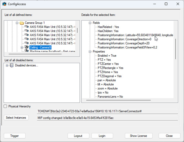

2, Also ConfigAccessViaSDK sample might be helpful.
https://doc.developer.milestonesys.com/html/index.html?base=samples/componentsamples/configaccessviasdk/readme.html&tree=tree_2.html
Run the sample and select a camera, then you will see PTZ Properties.
