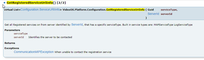

I could use this:
but what serviceType should I use to get mobile server?

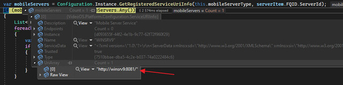

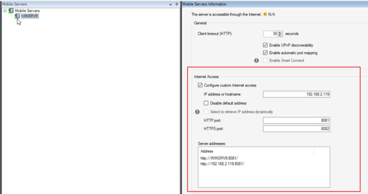

Edit: I’m getting MessageId.Server.ConfigurationChangedIndication but when I’m calling Configuration.Instance.GetRegisteredServiceUriInfo, the UriArray property does no contain all URLs defined in management (red area on image above). How do I get all URLs?
If I disable default address the UriArray still contains the default adress and does not cotain my new custom address.

Thanks now I can use GetItemConfigurations but I do not see mobile server URLs array (the red area “Internet access” on image above) in properties. How many addresse can be in that array? Is it just default address and 1 custom address?
I see property called Properties and it’s key-value pairs. Are there properties for mobile server URLs? What I need as a result is array [http://winsrv9:8081/, http://192.168.2.119:8081].
