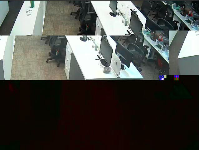

We run into another problem, the image of the first request is successfully obtained, but then when we add the RequestId (adding from to 1) and AlarmTime (adding 80/120), obtaining a request like this:
'<? xml version = "1.0" encoding = "UTF-8"?>
3
goto
1626870527515
100
no
\r\n\r\n’

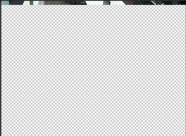

The following images are partially received, that is, with faults:
What could be the reason?
Again thank you very much.
Lautaro.
