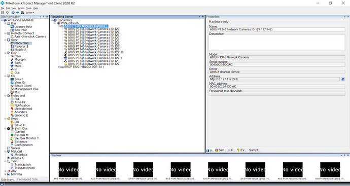

Can you see the information you seek in the Management Client? if yes, can you please show it in a screen capture?

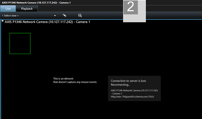

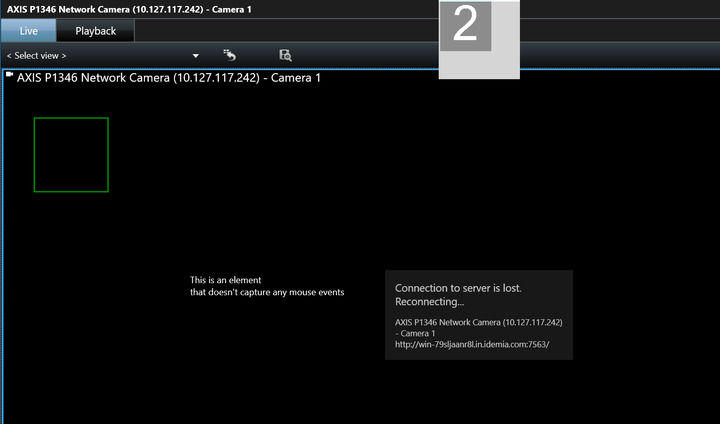

Hi Rie, Strangely enough not.. I am not able to see it in Management Client. I am able to see the Camera IP under Recording Server → Hardware. Also, I am able to locate the username/password. Now I am confused how can I play the stream from the camera in Management Client or the Smart Client. Normally, I would have expected the rtsp url to be used to show the stream from the camera and stored somewhere in the management client, but this is not the case. I tried giving the rtsp url in place of “Address” to see if I can stream, but I cant (see screenshots attached). Sorry, my question wasn’t clear enough at first, but any help, on how I can play the stream ?
