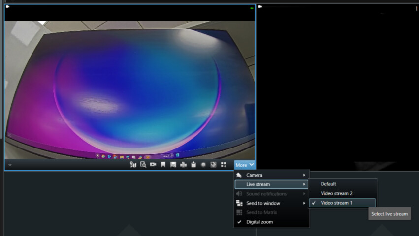

How to get selected Video Stream details from the ViewItem in Live workspace
How to retrieve the Selected Video Stream details from the the ViewItem in Live workspace using MIP SDK plugin development?
That information is unfortunately not available through the SDK and APIs.
Thank you for the confirming.
Could you please suggest some alternatives to get selected stream value?
OR
Could you please arrange to get it avail on upcoming Milestone release?
There is unfortunately no alternative today. I have informed the product manager about your request and it will be considered for future prioritization.
