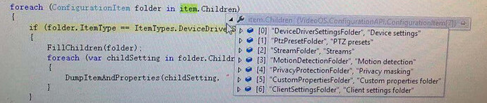

I’m writing code for controlling PTZ. I searched keyword “PTZ”, “patrol” etc related keyword in the SDK documents. It seems PTZActivePatrollingSchema is related. However, I didn’t find any place to get the PatrollingSchema or Patrolling profile. What’s the API to get/set PTZ patrolling?
Btw, I also tried to get info from configuration API. It returned all camera’s related configuration except patrolling. See picture below.
Does anyone have ideas about this?
Hi Karol,
Sorry for the delayed response. Unfortunately we currently do not have support for configuring patrolling through the SDK or APIs, so the only option currently is through the Management Client.
We have it on our backlog, but I cannot say when it will be done.
Best regards,
Peter
