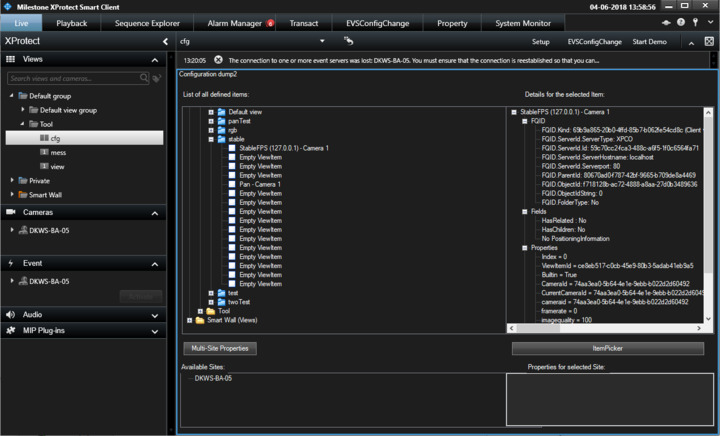

You can read the configured views in the Smart Client environment, you cannot do so in an Event Server plugin. For an overview of what you can do in the Smart Client I suggest you run the Config Dump tool plugin sample in the Smart Client, it can both show you which cameras are in a view and for cameras show related metadata and it might be what you seek.
We tried to get the details using Config Dump DLL. But we didn’t see the Tool in the view panel you mentioned above. We placed DLL in “[C:\Program](file:C:/Program) Files\Milestone\MIPPlugins” folder. We are running Milestone server and Milestone client in different machine.
