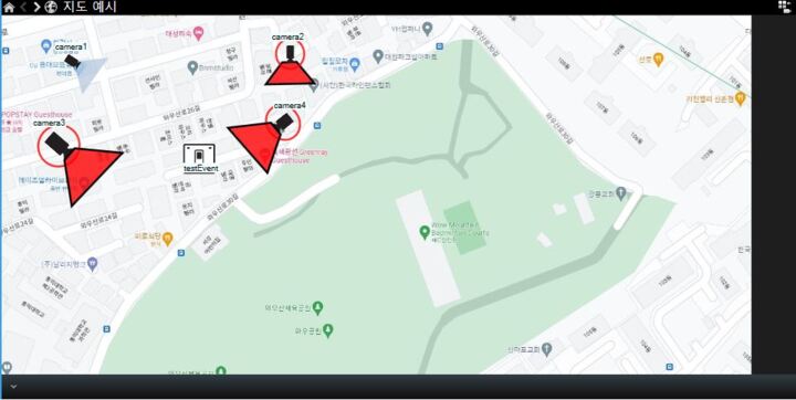

Hello, we are using the essential+ version, and after placing the camera on the map, we set the event on that camera to trigger the alarm. The problem is that the red circle keeps blinking around the camera once the alarm is activated. I think it will turn off when I process the alarm, but I can’t find a way to handle it. Is there a way?
Essential+ has no Alarm Manager. Ref. https://www.milestonesys.com/community/business-partner-tools/xprotect-comparison-tools/product-comparison-tool/
So, when using Essential+ you should avoid making alarms.
