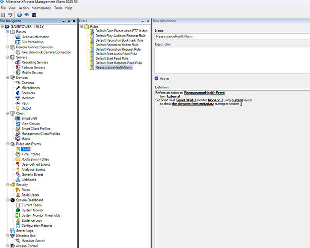

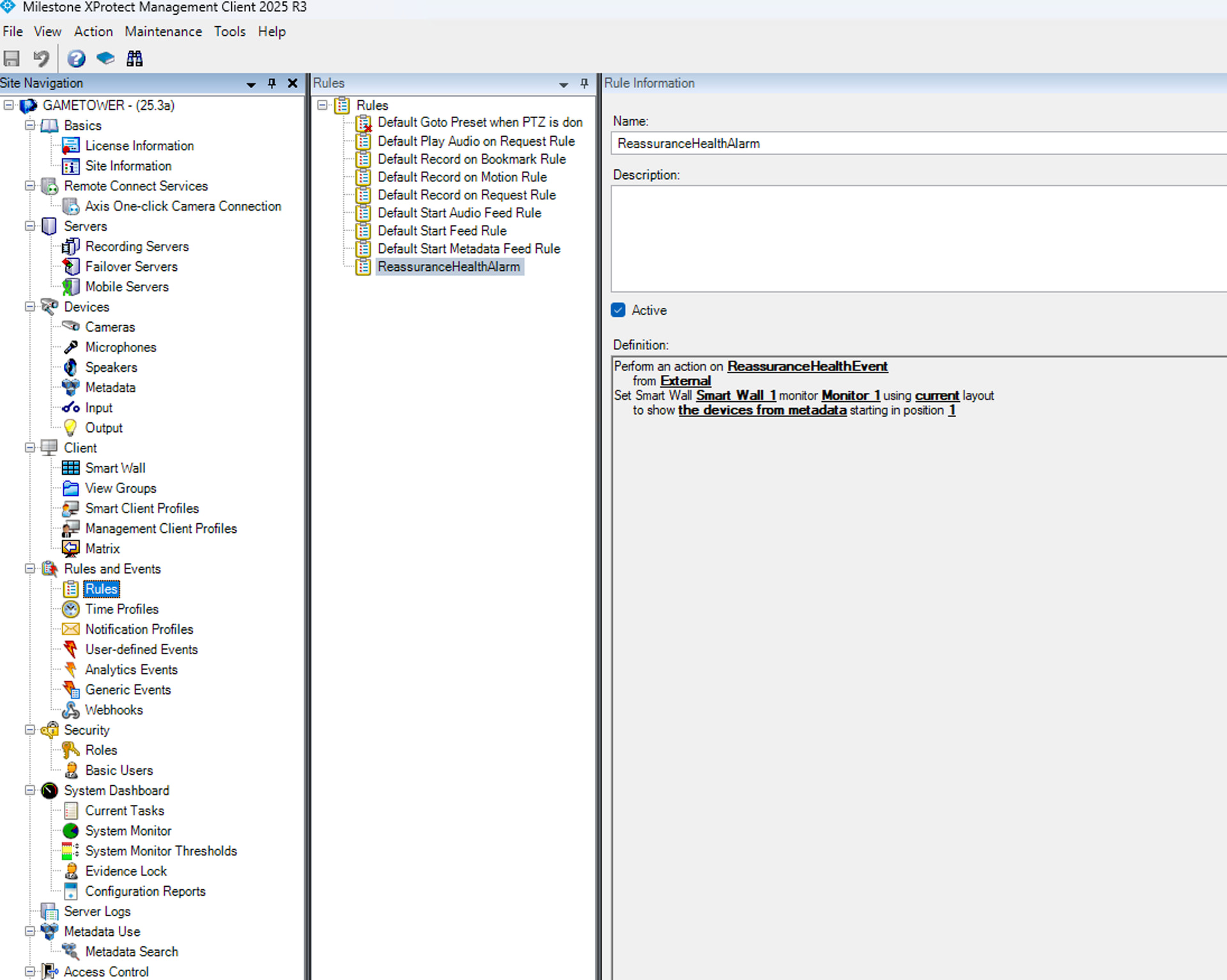

  3. A rule that I hoped would trigger the camera to be visible in the “Focus“ monitor - Monitor 1 (See Screenshot ReassuranceHealthAlarm Rule below)

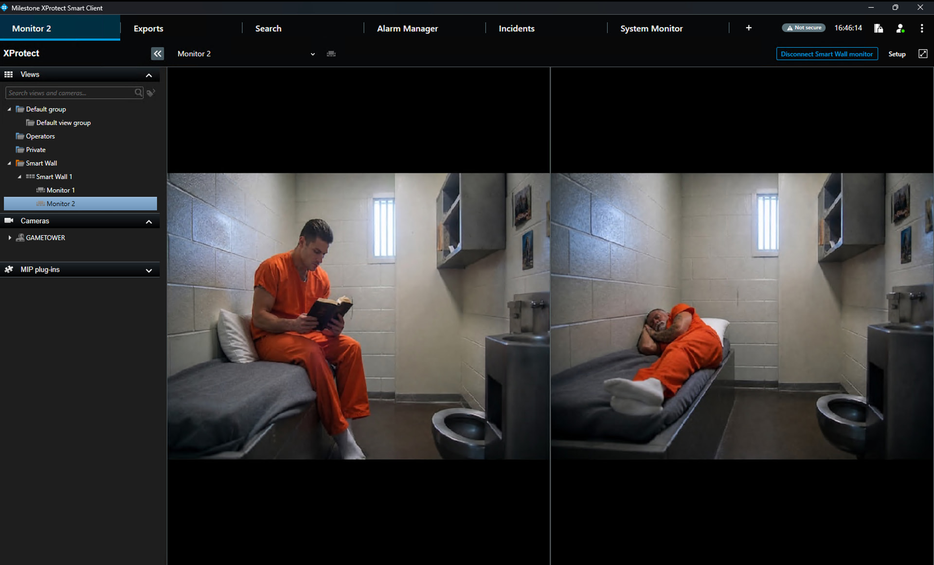

  4. A Smart Wall with 2 Monitors.
    1. Monitor 1 will serve as the “focus” monitor where I would like to display an inmate if their medical condition needs to be checked
    2. Monitor 2 will serve as a generic view where all the inmates within a facility can be observed (See Screenshot smart client - All)

Screenshot smart client - All:

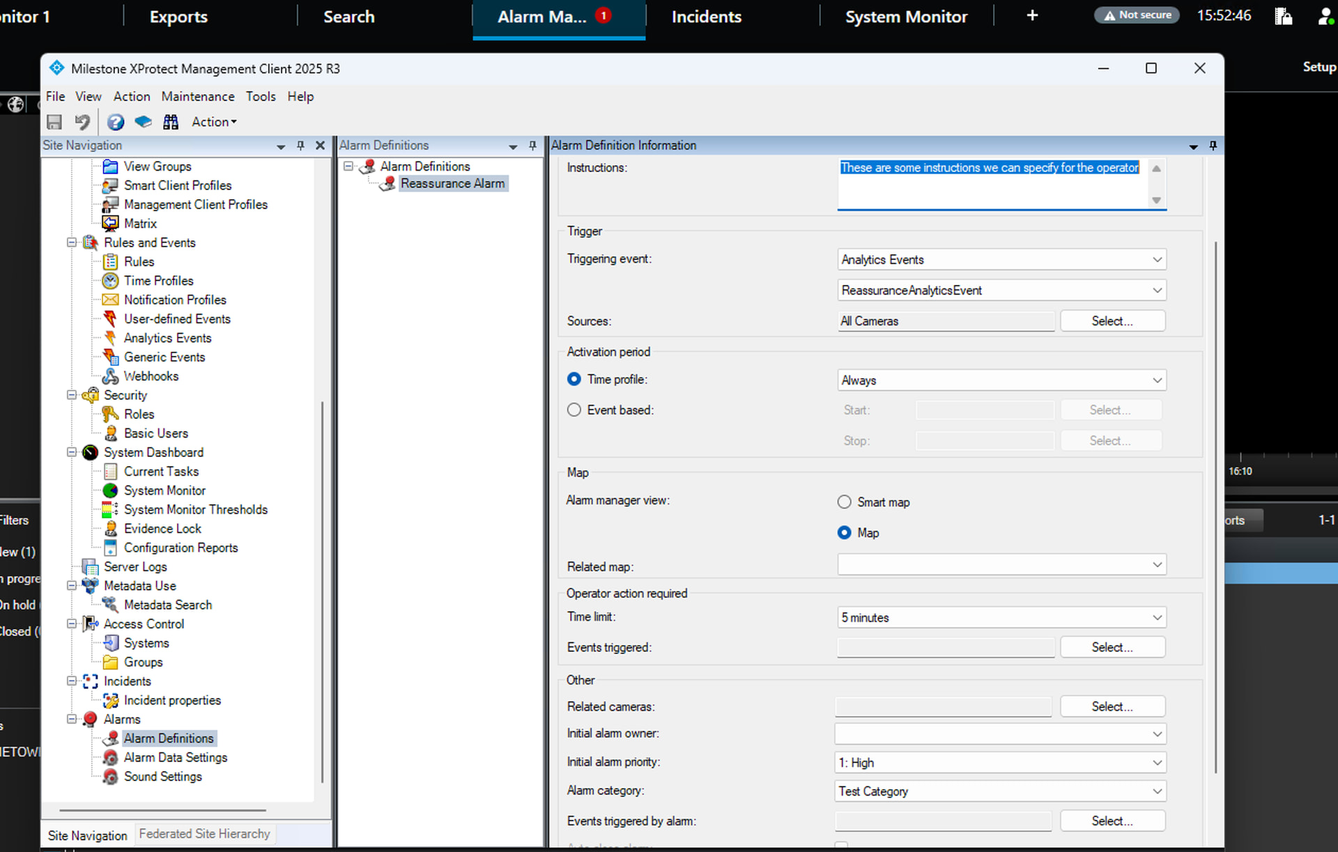

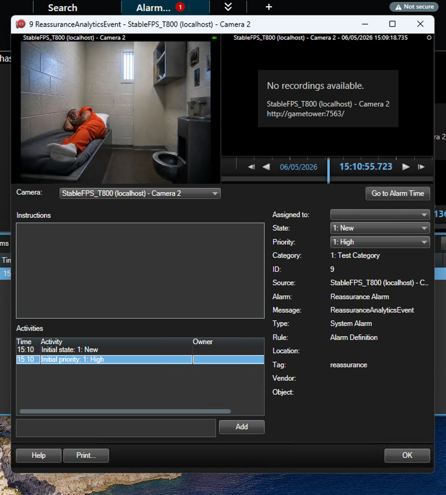

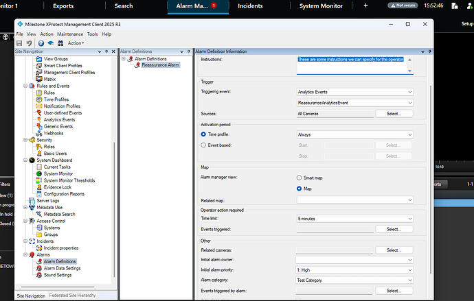

Last part of the puzzle: My alarm definition has instructions specified. However these do not show up on Smart Client
Triggered alarm:
Alarm definition:
I have a strong feeling this is a know issue and a patch exists. Please apply the newest patches to the system and client. If it does not help please let me know the version of the XProtect VMS and the Smart Client used.
