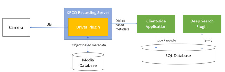

Ideally, we would like to make our Driver plugin pulls object metadata from cameras.
Driver plugin uses MIP SDK to record metadata in Milestone Media Database.
Client-side application uses MIP SDK to get metadata and store in local SQL database.
Deep Search plugin send SQL command to local SQL database query results.
Actually, you did answer my question for license usage. that we do have a camera working on the Onvif driver, and next to it a device (actually, the same camera) working on MIP driver, this is two devices and uses two XProtect camera licenses.
We will try the other methods to make our plugin work on SmartClient without additional license charges. Thank you for the license info. & confirmation.
