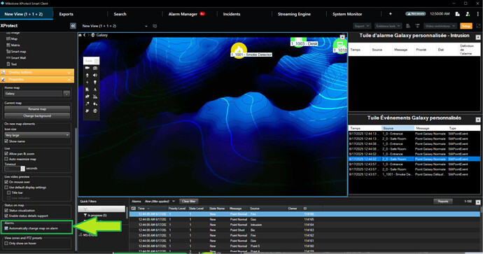

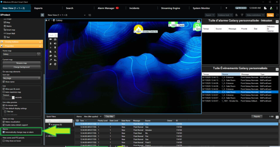

I can try it out, but it is not obvious to me how the map would automatically change to the right submap when an alarm is selected.
The goal is to select and alarm and have the map change, so subscribing to the alarm line selection won’t help, we would need to be able to send a message to the Smart Client which a normal map tiel would listen to.
It there a way to perhaps ask dev it is possible to send a message using EnvironmentManager.PostMessage with the alarm defnition ID in such a way that the map view item would recognize it?
I know I have had the question before whether it was possible to control the alarm list and by message or command have it jump to an alarm line. For this question the answer is no, there is currently no interface to do that.
I know that when looking at the Alarm Manager workspace, the map that is displayed is governed by the alarm definition, when the user picks an alarm line the map changes to the map specified in the alarm definition for the alarm. Is this what you want to mimic for your view item? I am trying to text the right context before consulting the Smart Client expert developers.
Yes, and just to be clear, we want it so that the map changes to the map specified in the alarm definition section when an alarm line on our view item is clicked
