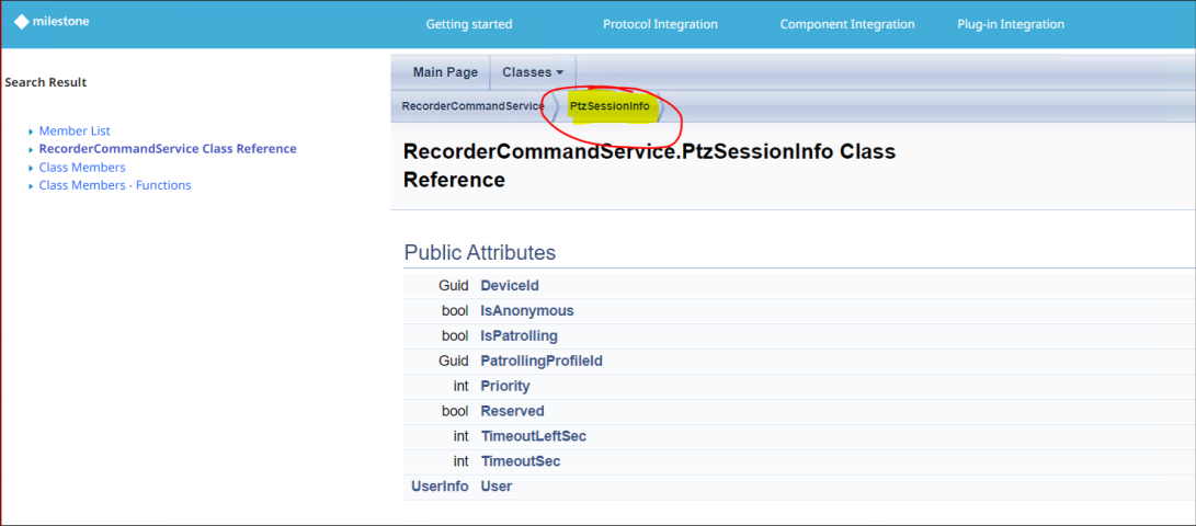

There is possibly a workaround.
If you in the Management Client (MC) look at the camera properties, the Presets tab, you can see “PTZ session”. This one is populated by the MC doing PTZGetSessionInfo on the RecorderCommandService once every second.
It is possible for you to use RecorderCommandService and PTZGetSessionInfo in your integration, unfortunately there is no support in the MIP SDK, so you will have to use the SOAP protocol directly. There is no sample that shows how to do this. From the VideoOS.Platform.Login.LoginSettings.Token you can get the token that you can use towards the RecorderCommandService. The token is sometimes renewed so you will have to handle that also. On RecorderCommandService :
https://doc.developer.milestonesys.com/html/index.html?base=recordersoaphelp/index.html&tree=tree_3.html
