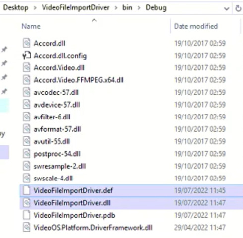

Hi Antonino,
Did you progress with the Video File Import Driver sample?
I noticed that you only copy two files to MIPDrivers\VideoFileImportDriver. At least the first time, you should copy all the referenced files as well:
