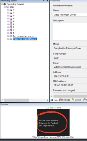

When adding the “Hardware” to the Recording Server, choose “Manual” and you’ll find the driver under “Other”, “VideoFileImportDriverSample”. It doesn’t require username/password, and it’s not using the Address:
imageafter addition, it should show up like this:
(note the still image, that confirms that you are connected).
Now you should be able to import a file!

When I restarted the Recording Server, VideoFileImportDriverSample appared under Other tab.
I added the hardware and the still image confirms that i’m connected.

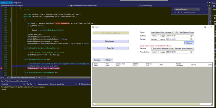

the exception “Cannot retrieve remote recordings from the devices” appears like in image attachment.
Why? The Device exists, the MIP driver is ok, star time is before end time, the mp4 file is located in XProtect Recording Server folder.

this code is in the RemoteRetrievalTaskSample, I tries to change parameter of RetrievalTaskManager:
private void btnConnect_Click(object sender, EventArgs e)
              try
               //_manager = new RetrievalTaskManager(EnvironmentManager.Instance.MasterSite);
               _manager = new RetrievalTaskManager("http://localhost/", 22222, "test", "test");
                _manager.Connect();
				btnConnect.Enabled = false;
                btnSelectCamera.Enabled = true;
			catch (NotAuthorizedMIPException ex)
				// The was a problem with login credentials. Check user name and password
				lblLoginError.Text = ex.Message;
            catch (MIPException ex)
                // There was a problem contacting management server. Check the address.
but this change throw exception.
