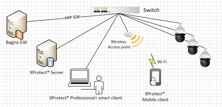

Jump in time (to a recorded time in the past via SDK) and play.
Change playing velocity x1, x2 x5 etc.
All these playing controls needs to be done through the SDK, over all channels recorded (Video and audio), to be played simultaneously and synchronized to our system via the GateWay.
So the result will be all channels presented on the XProtect smart client.
I’ll appreciate some info on how to use the SDK for these requirements.
You put a tag “Protocol Integration”, are you going to do Protocol Integration or Component integration? Or perhaps plugin as you also say “So the result will be all channels presented on the XProtect smart client.”? Do you have one or multiple clients needing to be synchronized? Can you use .NET and the MIP library?
If you use MIP library, Component integration, PlaybackController might be the answer for you –
