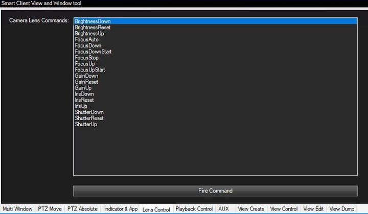

I have spent some times to look through the Smart Client View and Windows Tool plugin sample. I tried firing all the Camera Lens Commands in the list of the following image:
However, NONE of them, perform the [FOCUS FAR] and [FOCUS NEAR] features I wanted as it does with those overlay buttons, see the following image:
So I guess there is nothing to do with the SCViewAndWindowsTools plugin sample?

In summary, I mean, when I try firing all the commands available in Smart Client View and Windows Tool plugin sample, none of them does the same things as both the [FOCUS FAR] and [FOCUS NEAR] overlay buttons did.

Might “Focus far start” be the same as FocusUp? This should be easy to test.
Thanks for pointing it out! I realized there is logical error which caused me to failed the test. Thanks again.
