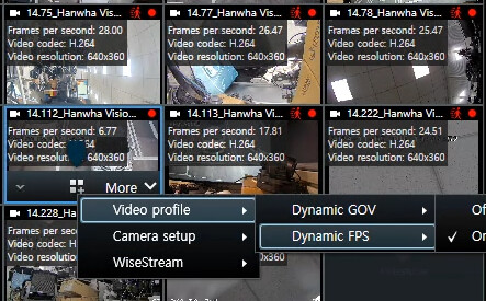

How to remove strange box generated from clicking a menu of ToolbarPluginWpfUserControl
Hello, I found strange behavior. Whenever I click a menu in my ToolbarPluginWpfUserControl, it leaves a strange blue box. How can I remove it? Thank you.

It seems to reproduce and don’t know why the strange mark is not disappearing.

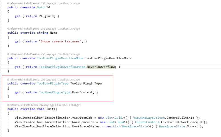

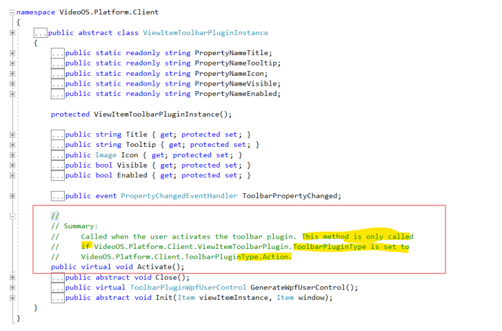

We have tried with the solution you have suggested.
However, it won’t work, as per the documentation, The Activate() method will only work for the ToolbarPluginType.Action and we have set the ToolbarPluginType.UserControl
We are using ToolbarPluginType.UserControl
When you use the ToolbarPluginType.UserControl type you do open the User Control which is the small blue box. This is how it is implemented to work. The context menu you make breaks the functionality and the blue box does not close again. The conclusion is that you cannot use it in this way.
