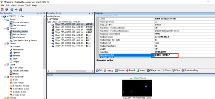

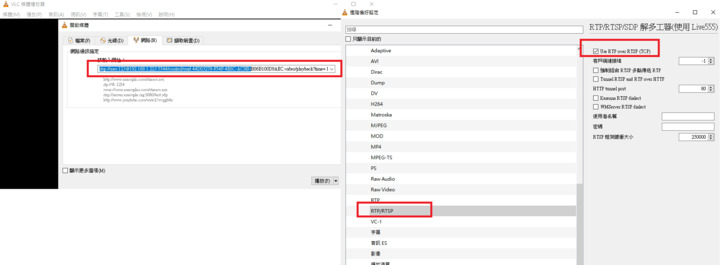

That’s my config in my vlc player as below.
​Milestone management client’s configI sure live and vod both parameters are work fine.
Does not suitable using below command to seek recording via VLC?
rtsp://user:123@192.168.1.223:5544/control/uuid:44D03279-F54F-4E6C-AC9B-B06B100D9AEC:video/playback?time=epoch time

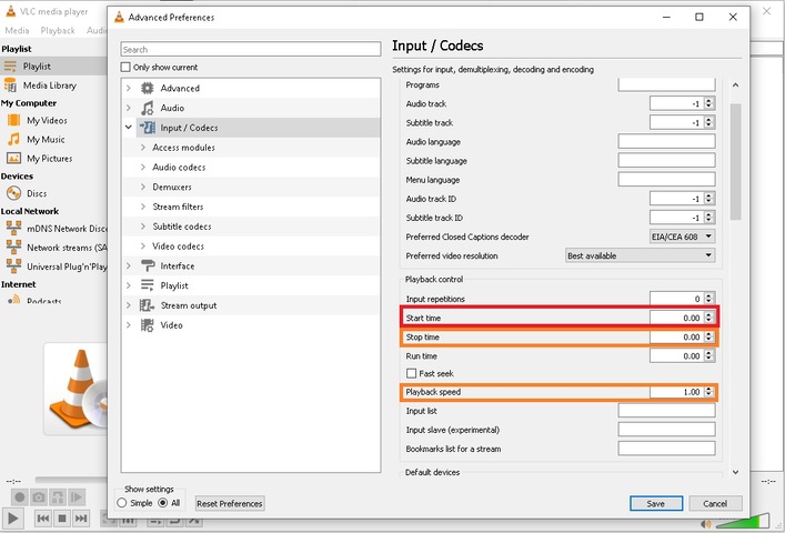

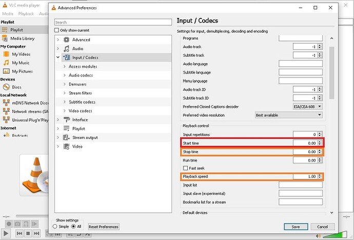

If you want to navigate to a specific time, you could set this up via VLC User Interface or starting VLC via command line.
The UI for changing playback parameters looks like this:

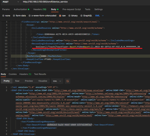

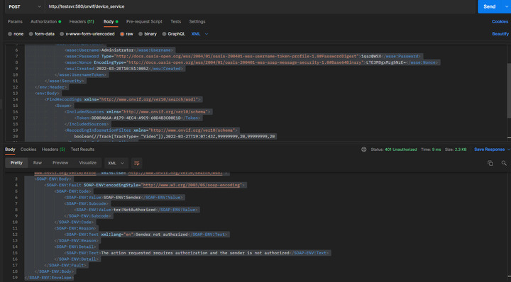

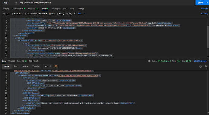

So i tried SOAP of FindRecordings via postman.But unfortunately! i stiil fail and got response “Sender not authorized” message after request.
Please refer to attached files my request and response. ​
I have found a lots of reference but still stuck now. The reference about user authentication ,invaild argument, time sync or disable replay attack feature.
Could you help me through this?
Hi @ryan chu​
On first look XML seems in correct format. Something in password hash generation however probably fails. I cannot comment on what exactly.
Are you using some built-in implementation ?
On what language / platform are you trying to integrate ?
Dear Petar:

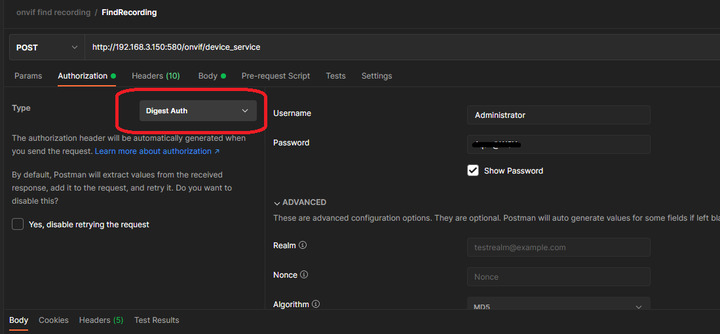

Thank your reply soon.I found issue was using Basic Auth.If i chose Digest Auth is work out.

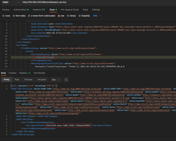

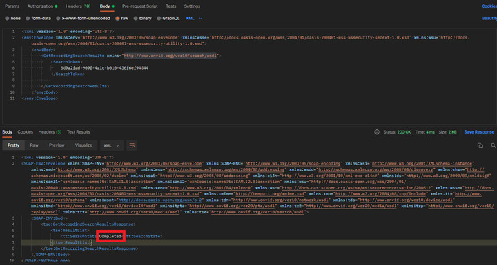

Now i meet new problem is no recording list from response.
The SearchState Just only show “Completed”
I also tried add option like Max/MinResults or WaitTime.But it does not work.
I found reference from forum.
https://mymilestone.force.com/developer/s/question/0D53X00007Qf5h2SAB/onvif-bridge-getrecordingsearchresults-response-empty
​I follow your post before that to modify the filter.But i seem like the same.
Please to refer attached of GetRecordingSearchResults and FindRecording request.
Great to hear!
I had to mentioned it before - ONVIF interface supports two types of authentication - the older WSSE, when there is a specific XML Security Tag and ad the newer Digest, where you could put authentication HTTP header.
For most integrations Digest is the preferred one as it is supported out-of-the-box in many tools/libraries.

I meet another problem of GetRecordingSearchResults
Please refer above section then expand post(Below picture)
Hi @ryan chu​
Parameters in FindRecordings seems correctly formed.
Unfortunately error cases in FindRecordings and GetRecordingsSearchResult are not well implemented. In such way you will receive “completed”, even if something is not completely correct with the parameters.
What I could advice you is to play a little bit with the recording filter parameters.
With this string:
boolean(//Track[TrackType= "Video"]),2022-03-28T11:07:43Z,0,0,99999999,20
You are trying to search in the interval from
“2022-03-28T11:07:43Z” to the “unlimited future” for maximum 20 sequences.
So you could:
  • check if there are recordings for the particular camera
  • change “central time” a little bit in the past. Right now it seems to be very close to “now”. And if you try to look for the recordings from “now” to the “future” - you won’t find anything. Bear in mind date-time here is in UTC.
  • try to put before time/count also
Or try all the changes :wink:
If I were you I would try at least:
2022-03-01T11:07:43Z,0,0,99999999,20
2022-03-28T11:07:43Z,99999999,20,0,0
2022-03-28T11:07:43Z,99999999,20,99999999,20

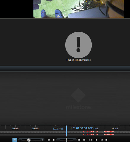

Unfortunately! It is still the same problem without recording list show up.I am realy sure recording files exist during 2022.3.26 till 3.28.(snapshot as below)
I was tried your recommand and found some information on internet,but not work out ! Now i do testing about FindRecording command. I don’t know even why without given camera guid token that itstill response a search token?
