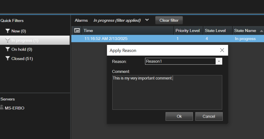

We need to reproduce the same popup that allows users to close the alarm with a reason.
Is there a way to reproduce this popup with the SDK in the Smart Client?

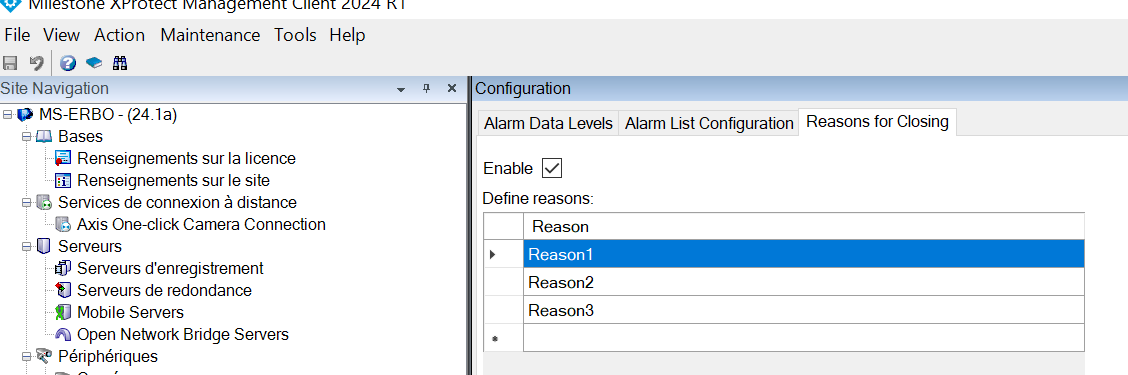

Right now, even though the “Reasons for Closing” is enabled in the Management Client, it is possible to bypass it when closing alarms with the SDK.

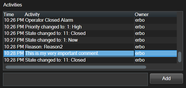

The desired result is to have the same Activity in the alarm history, including the Owner or Smart Client user:
