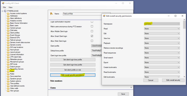

Go to Roles and select a Role and see Rolemember.
And then, as you can see below: Edit overall security permissions – select Cameras then you will see Read, viewLive, LockPTZ_presets, playback etc.
NOTE – a user can be a member of multiple groups: you need to check all groups who is members of the groups.

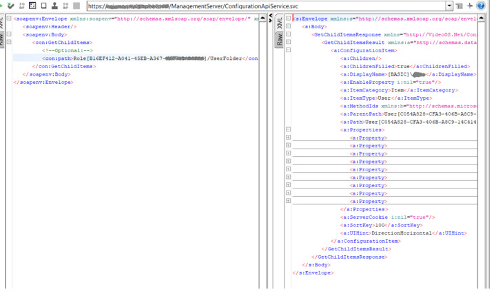

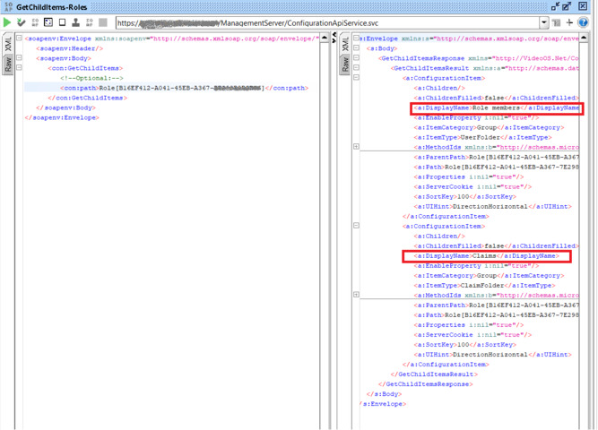

  1. In relation to the second question/response, if we use the SOAP Configuration API service of the sample (operations: “GetItem” and “GetChildItems”), the roles’s childrens, we can view the users/members list, and the claims, but the Security Permissions not exist in the tree of items.
The role members are users associated to the role, but they haven’t attributes or properties with the security permissions:

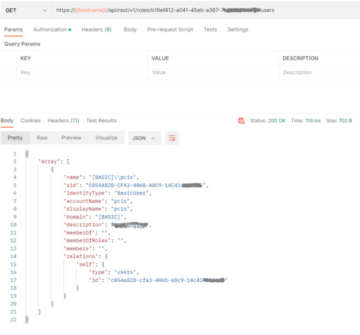

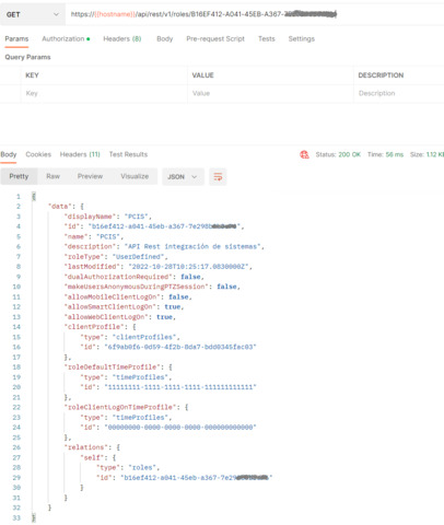

If the new Milestone Integration Restful API (API Gateway) is used, the information is similar: Roles only have rolemembers/users and claims, but the security permisions don’t exists:
Rolemembers/users of a Role:

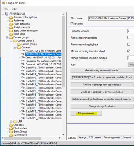

  2. I am sorry, I wrote wrong instructions in the previous post. You might want to see rather camera – permission in ConfigAPI Client. Please see below.
