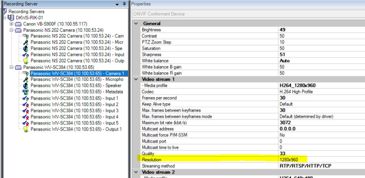

You might already know but let me explain the flow of recording.
First of all, it is possible to set up resolution in Management Client (see below).
Recording server (RS) gets this setting from Management Client and communicates with cameras. It also asks for images from the cameras according to the settings and store the images.
