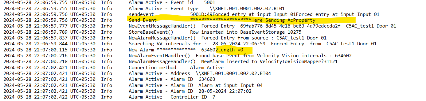

but the property length seems to be zero. I have attached my screenshot below

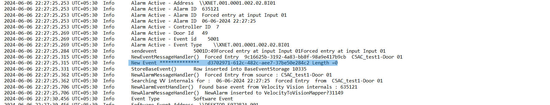

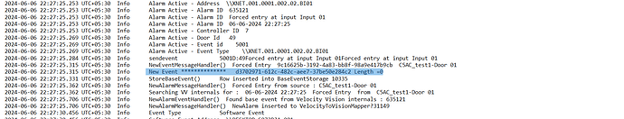

I installed the latested version of Nugets to my plugin project and it pretty much didnot affect anything in the plugin. So I was successfully able to build the project. But still I am not getting any AC Properties in the “NewEventIndication” Listener
I am trying to print ACProperty length as below
ACUtil.Log(false, "New Event ************** “, ac.AccessControlSystemId.ToString() + " Length =” + ac.Properties.Length.ToString());
