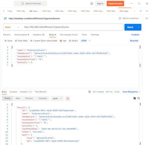

Hi,
I’ve solved my issue. It was a bug in the previlege and token assignment.
Now I’m able to create a new GenericEvent and get JSON answer as expected.
Thanks for the support.
NOTE: I’ve attached a POSTMAN screenshot as a result of the resquest.
Best regards,
Ramzi
