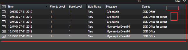

#2 We want to add some columns at smart Client, whether this is possible?
Because we want to display more information at Smart Client?

#2
In the document you see in the chapter “Show custom information in the Smart Client.” how to extend the display in the smart Client Alarm List to show extra columns, and you see in the chapter “The correlation between Smart Client Alarm List and the Analytics Events tags.” how to put the informaiton in the event XML to populate the columns. You cannot create new fields but you can fill out and use Vendor, Location, Tag, Type and Object fields.
