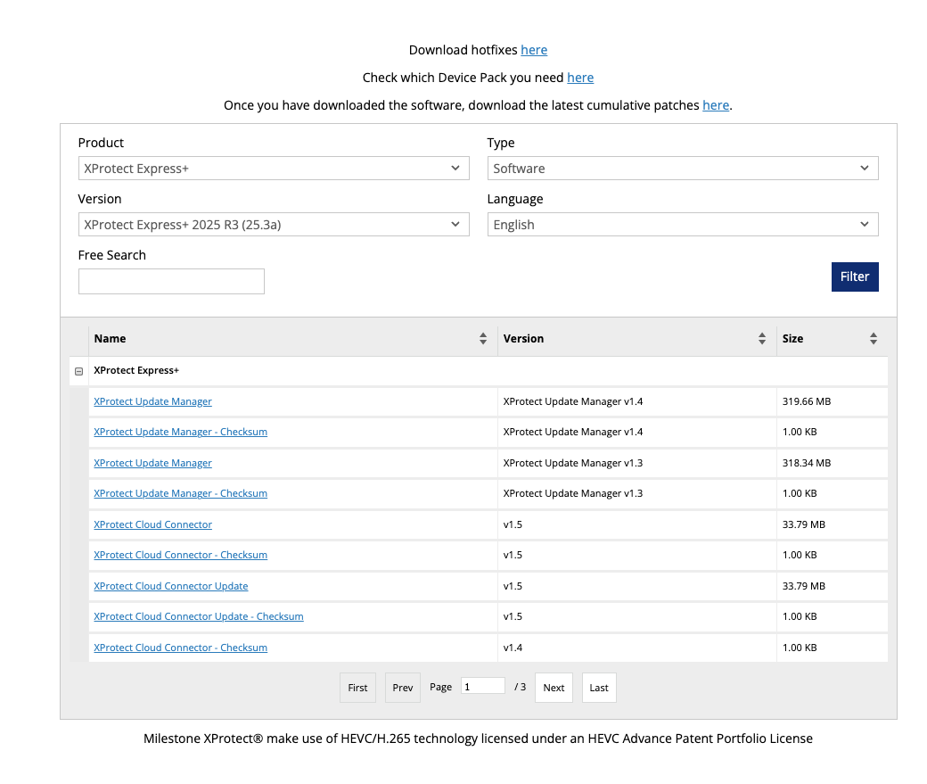

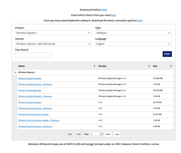

I found the alarm trigger api & a quickstart guide, however when attempting to request a license and download the software I am a bit lost with the options in the download page.
Can you please advise on which version to install to have the ability to check the alarm api? (and provide installation steps if this is a more complex process?)
