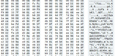

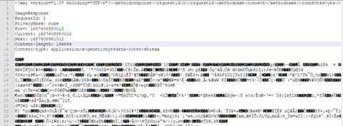

Here is the raw data we get from goto function(which should be a data of one frame?). Can you please help us how do we manipulate the Binary text to get the video file?
We open it in a free hex editor.
I have taken a look at The GenericByteData format documentation. And I didn’t find similar field value that indicates me it’s from H.264 or some other video types. So I am confused about what kind of data this raw data is. So if you can help us how do we read the data as a video file would be plenty.
When we converted the Binary data to JPEG we just removed the header part. Is there any easy way to transform this binary data that we have received to a video file? (May be by removing the header or the genericbytedata header and renaming the file to any video format like avi or mp4).
I had gone through the Milestone Generic Byte data documentation. I understood the formats of data but I would like to know if you can help me with any guidance to convert the GOP data to video. https://doc.developer.milestonesys.com/html/index.html?base=mipgenericbytedata/main.html&tree=tree_3.html
The MIP SDK does not really have functionality for handling raw video data gops except of course for retrieving it.
The GenericByteData format is documenting how to remove the header so that you have the raw data. Nowhere is there documentation or samples on how to handle that raw data. There might be followers in this forum that can help. But you might get better help if you find fora on video handling or transformation outside this forum.

When it comes to using the Image Server protocol directly to retrieve video from the Recording Server the video data is raw, it is the original video data from the camera encapsulated in a small header, this is the GenericByteData format. Read about it here. https://doc.developer.milestonesys.com/html/index.html?base=mipgenericbytedata/main.html&tree=tree_3.html
When you have removed the header you have raw video data, the MIP SDK contains no functionality or documentation on how to work with raw video data (except retrieval and export using the components mentioned above). I recommend that you seek information in other communities or forums that deal with video data.
