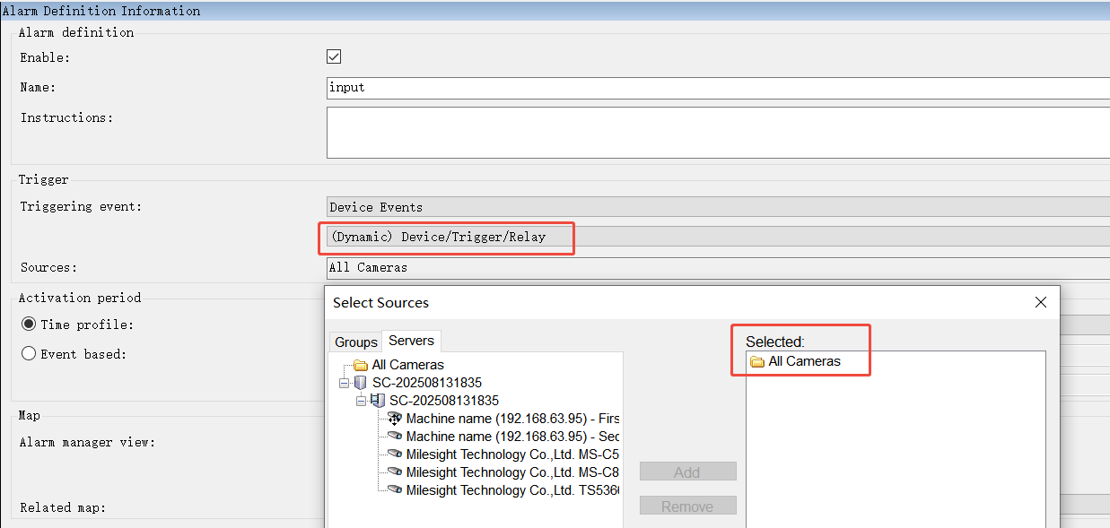

My camera is driven by onvif. The input device of the camera will report the Device Event which named Device/Trigger/Relay.
In the rule page, I can configure the input device for this device event.
But in the alarm definitons page, I can’t configure the input device for this device event. Its source device can only be camera, which makes the alarm unable to be triggered.
Other non-camera device events also too.

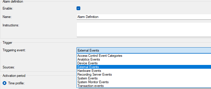

Hello Alex Lin,
You can select ‘External events‘ from the list
Then from ‘Sources’ you can select from inputs groups.
