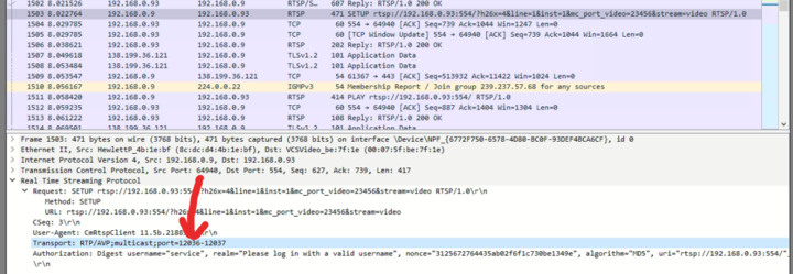

When I try the same thing with the Bosch, gstreamer works fine and using wireshark I see the correct ip and port set up in the camera. But when I use with Milestone, it uses the correct ip but a port which is different and random every time.

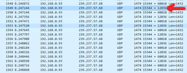

Using whireshark I noticed that when Milestone tries to start the rstp session, it sepecifies a “port” (see first image) when performing the SETUP step of the rstp protocol. That same is the one that will be used used while streaming (see second image where you can see port 12036 used by Milestone and port 60010 used by gstreamer and the same set in the camera). This means that the traffic on the network is doubled.

Is there a way to remove the “port” parameters for Bosch?
Note: even changing the parameter “Multicast port” from the management client has no effect, the port is still random every time I start the stream
