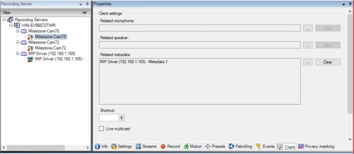

Hi Peter, You mentioned demo driver in your comments, kindly let us know if you are referring to the Demo Driver under “[C:\Program](file:C:/Program) Files\Milestone\MIPSDK\DriverSamples\DemoDriver”. There is no code for this (refer to the attached screenshot). However, we tried to extend the implementation of MultiChannelMetadataProvider by creating one MetadataProviderChannel per camera and using this for updating the metadata. The main problem we have only one active session.
Source code for all our samples can be found on Github: https://github.com/milestonesys
Demodriver is using the MIP Driver Framework, but I now realize that you are using the build-in MIPDriver for your integration. That approach can also support multiple metadata channels - an example of this is: https://doc.developer.milestonesys.com/html/index.html?base=samples/componentsamples/multichannelmetadataprovider/readme.html&tree=tree_2.html
However, the MIPDriver will always do one connection per channel, so if you want to use that you will have to implement the other end so that it can support multiple sessions.
Alternatively have a look at DemoDriver and add multiple channels to that one, but then implement all of them to use the same communication channel towards the other end.
Hi Peter, As shown in the attached screenshot (Config.png), we are creating a single MIP driver listening on port 52124 and attaching this with two cameras namely Milestone cam 70 and Milestone cam 72. So with this configuration, if we write the metadata using Metadata provider, it is writing the bounding box on both the cameras. Kindly let us know how to avoid bounding box displayed on both the cameras
As I wrote in my previous answers you need to have multiple metadata channels (you only have one). Have a look at the sample I linked in my previous answer.

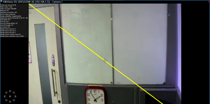

We are able draw a line using the Analytics overlay plugin (refer to the attached screenshot png file). However, this is not getting saved in the recorded video. So when we perform playback at the specified time this overlay is missing. Also, we need draw lines on multiple cameras. Kindly let us know if this is feasible. Thanks in advance.
The sample shows how to draw on a single camera, but there is nothing stopping you from doing the same for multiple cameras. The drawing is done on top of the video and will never be embedded in the video as that would be considered tamping with evidence. We do not allow doing any modification to the recorded video.
However, you can also draw on the cameras in playback mode. Of course you need to access the source of the metadata used for the drawing at that time as well, so either you have to ensure that the metadata stream is recorded along with the video, if the data come in a metadata stream, or you should retrieve it from stored alarms (or events) if the data is included in those.
