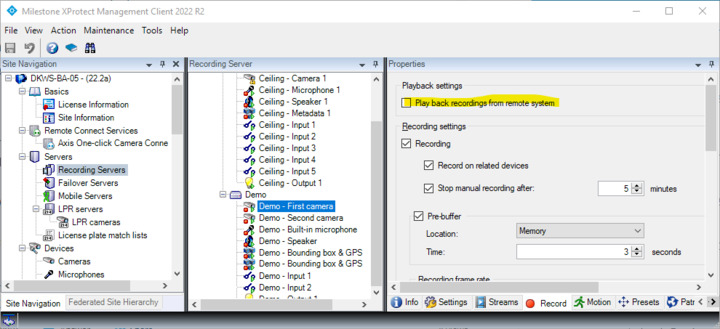

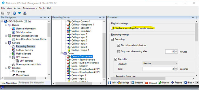

If you implement a driver framework driver and implement support for edge storage you can simply use the “Play back recording from remote system”
This screen capture shows the driver framework sample from the MIP SDK. - https://doc.developer.milestonesys.com/html/index.html?base=samples/pluginsamples/demodriver/readme.html&tree=tree_1.htmlHi @Bo Ellegård Andersen (Milestone Systems)
