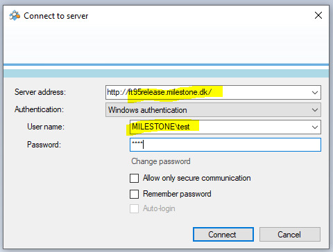

Please try not to use “Allow secure only communication” if you see the checkbox?
secure onlyRegarding server address, do you use fully qualified domain name (FQDN) or localhost or IP address or hostname?
Also, try to test with a domain name + user name when you login as a Windows user.
Are those machines on the same network?
It would be great if you could put a screen capture of the login dialog with a username and hostname and so on, but this is public Forum so I don’t know if it is possible for you to do it … but if it is possible please put it here.
