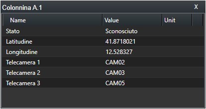

If you use context menu from map icon you have “Status Detail” that looks like the following image
In order to do that you have to override GetItemStatusDetails in your Item Manager
