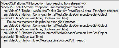

I am facing a issue when sending multiple driver metadata to Xprotect VMS
this error is showing up when my program try to send some metadata to the VMS

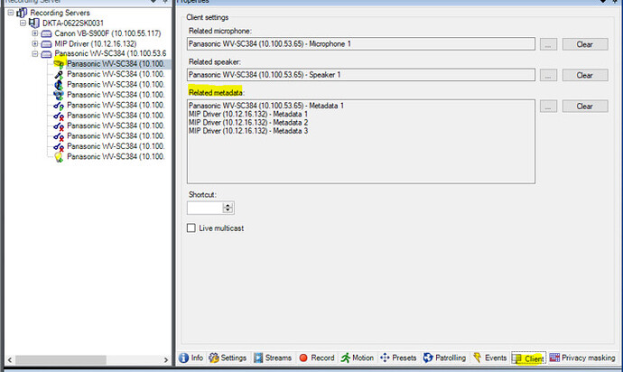

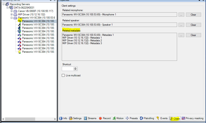

I tried to send the bounding box metadata to more than one camera with this sample, but on the Smart Client don’t give me the option to enable the bounding box.
PS: I already have connected the metadata driver on the camera inside the Management Client
I have tested the sample and it works fine and it is possible to see the boundingbox in Smart Client.
Can you please check if you select right metadata as Related Metadata on Management Client?

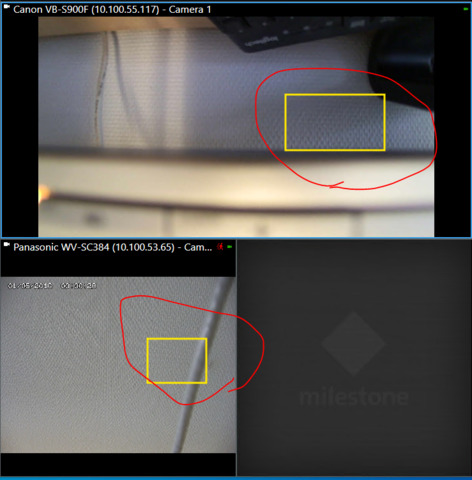

that was the problem I mentioned, but my real question is, it is possible to send metadata to two or more different cameras in Xprotect(using the VideoOS package)?
I believe this is what my colleague Rie shows, sends the metadata on one metadata device and uses the metadata device through setup to do overlay in two different cameras.
