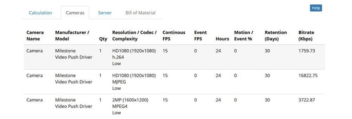

Currently i am designing a hardware and bandwidth requirements for BWC to be connected via 4g to milestone back-end system.
but if i use 1080p,0 FPS the bandwidth for iphone is 16 Mb/s this is hige for for 4g data to subscribe, so i was wondering if we can do some thing to work H.264 or MPEG 4 which will fall under2 -4 Mb/s much lower.. based on the image i attached. i am stuck with this can assist
Those calculations seems to be completely valid.
Unfortunately required bandwidth for video push with Full HD resolution and higher FPS is enormous (especially for 4G).
The only thing I can advice you at the moment is to be lowered resolution to HD Ready for example (720 p).
It will be compromise between quality and bandwidth.
(I see you probably already considered something similar, according to the calculations.)
