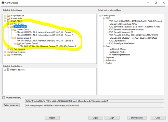

Please see Configuration Access sample, it might be helpful for you to see how to get cameras under camera group.
https://doc.developer.milestonesys.com/html/index.html?base=samples/componentsamples/configaccessviasdk/readme.html&tree=tree_2.html
This sample will illustrate how the configuration is ordered in a tree structure. In the sample notice the option “Physical Hierarchy”. Notice that when this is used cameras will no longer be grouped by configured camera groups but will instead be grouped by physical setup -recording servers.
