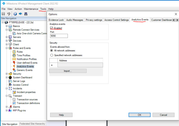

Start Management Client –
Tools - Options - select Analytics Events tab. Check on Enabled and click OK.

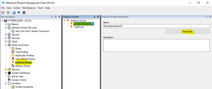

Add an Analytics event and click Test Event.

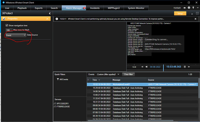

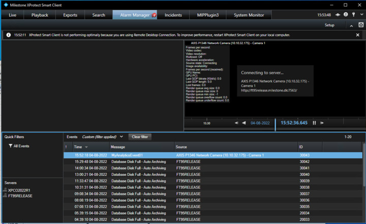

If you want to see the triggered event, start Smart Client. and go to Alarm Manager tab.

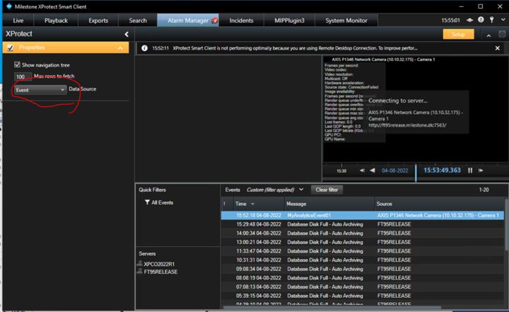

Select bottom list and go to Setup mode.
Select Event to see all events in the list and escape from Setup mode.
Then you will see all events.
